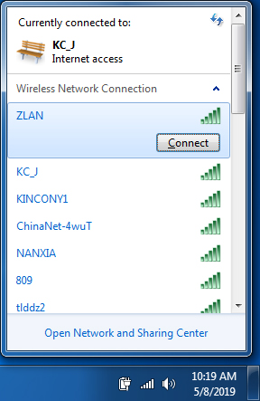

4.1: Let your computer to connect WiFi wireless network name of “ZLAN”

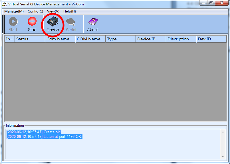

4.2: Open the program of “Vircom Network tool”
4.3: Click 【Device】

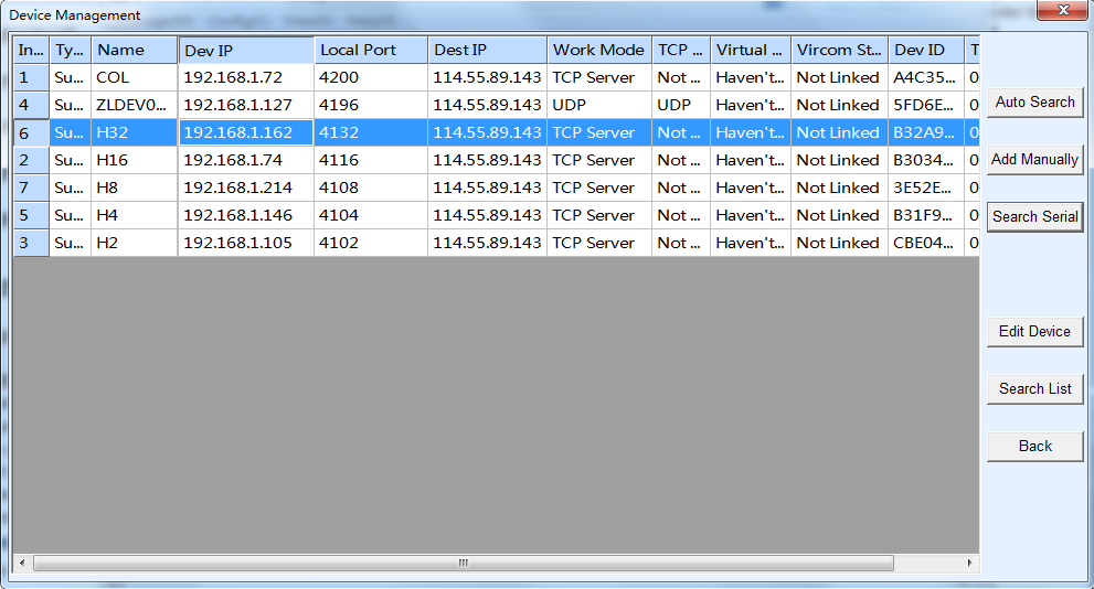

4.4: Click 【Auto Search】 There will find your controller item.
4.5: Click 【Edit Device】

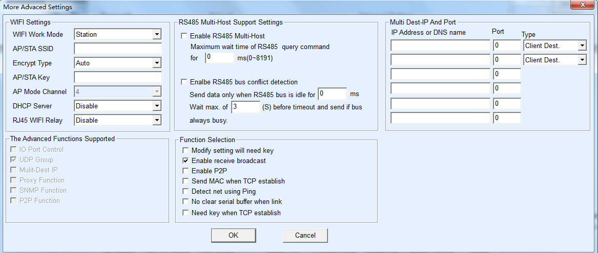

4.7: Click【More advanced settings】
4.8: Choose “Station” for 【WIFI Work Mode】
Input your router’s name for 【AP/STA SSID】
Input your password for 【AP/STA Key】

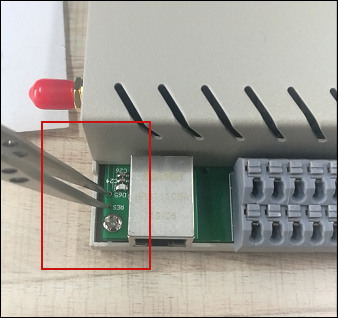

If you want to reset wifi for new config, you can short “RES” pin for 1 second.

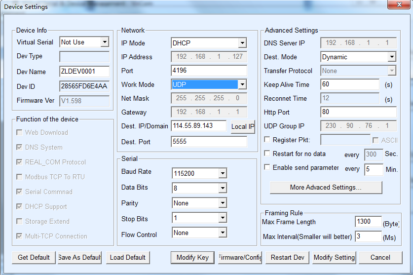

4.10: Choose “DHCP” for【IP Mode】Choose “UDP” for【Work Mode】
4.11: Dest IP/Domain: 114.55.89.143 Dest Port: 5555
4.12: Click 【Modify Setting】to save config
4.13: Re-start power for controller
4.14: Wait for about 10 seconds controller will be connect with your router.
This 【Work Mode】you can use “KinCony Smart Home” app and PC software for remote control.
