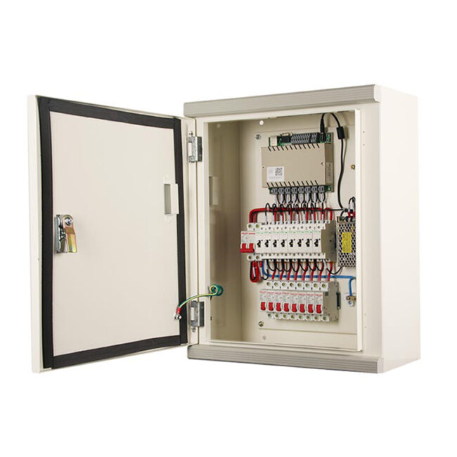

Smart Power Switch made by KC868-H8 controller
 Power Distribution Box can control all kinds of electrical equipment and connect sensors to realize the function of security system.   The video will show you step by step how to DIY the box.The whole production process was recorded.   KC868-H8 relay remote control module series video: kc868-h8 ethernet network relay control Building model…

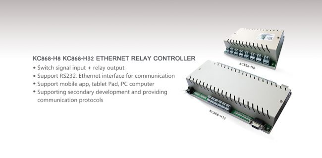

KC868-H32 relay remote controller Parameter and Installation
Products Parameter: Dimension:      272x117x40mm Working Voltage: DC 12V Material:Fire resistance ABS、metal shell Working Temp: -20℃~70℃ Working Humidity: 20%RH ~ 80%RH Output Load:each 250V/3A Communication mode:Ethernet/RS232 Input port qty:6 ports Output port qty:32 ports   Products Function: Supporting RS232 and Ethernet communication mode Remote controlling the opening/closing of 32 routes or 32 groups’ circuits. Supporting 6…
KC868-H8 relay remote controller Parameter and Installation
Products Parameter: Dimension: 148x117x40mm Working Voltage: DC 12V Material:Fire resistance ABS、metal shell Working Temp: -20℃~70℃ Working Humidity: 20%RH ~ 80%RH Output Load:each 250V/10A Communication mode:Ethernet/RS232 Input port qty:8 ports Output port qty:8 ports Output power:12V/9V   Products Function: Supporting RS232 and Ethernet communication mode Remote controlling the opening/closing of 8 routes or 8 groups’ circuits.…
